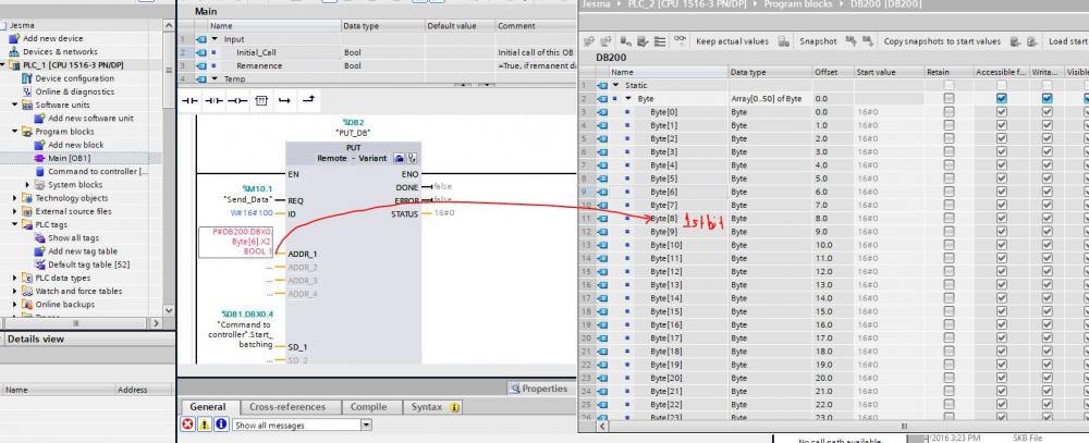

Jump to content
Tia Portal - Bit to byte array element via put command
Posted
Hi,
I am trying to send a true bit (1) to the 1st bit of the 8th byte element of an array at a remote (partner) PLC through the Put FB. In the remote PLC, the array is stored in the [DB200] data block. Does anyone know what I should type in the ADDR1 field?
I always get error messages as in the attached screenshot
Thank you
Posted (edited)
Can't see the error message
The "DB200.DBX0.Byte[6]x2 BOOL 1" looks weird, as in address is wrong. I will try it out tomorrow and see how it compiles.
Edited by tom91_uk
Register a new account
Sign in
  • Create New...
