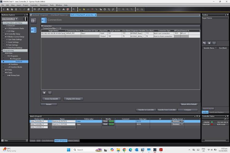

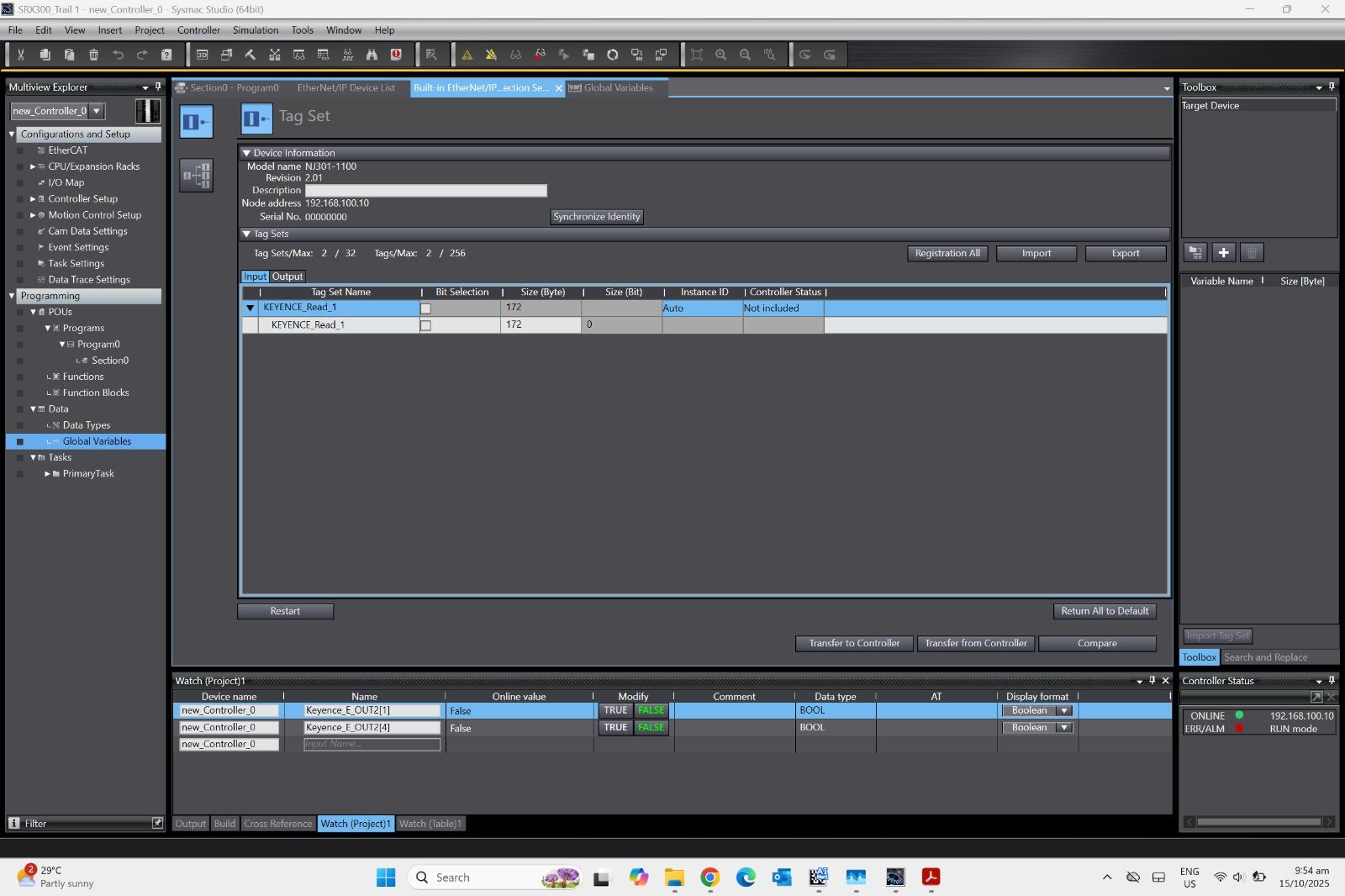

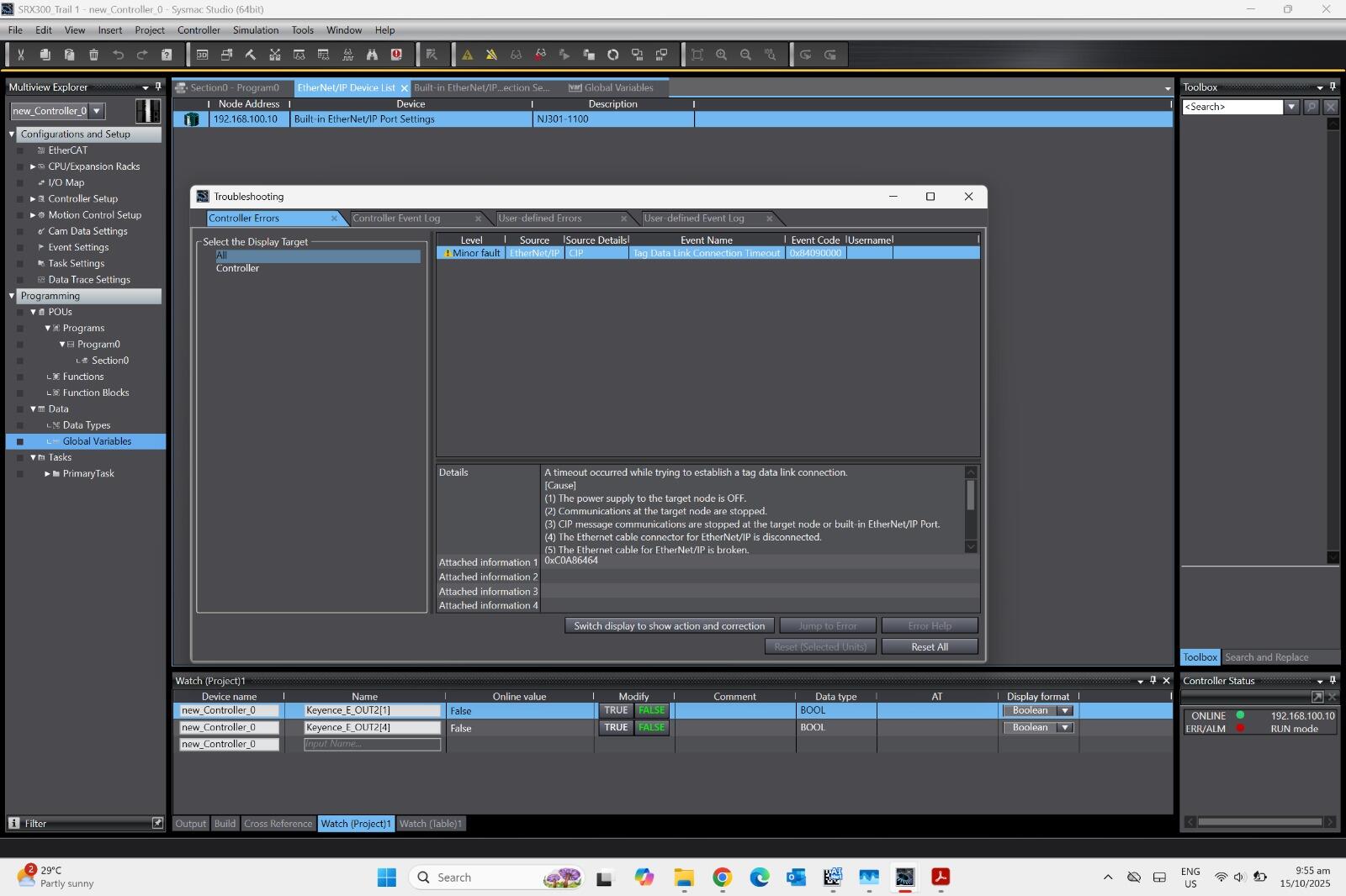

Jump to content
Posted
I am using Keyence SRX300 code reader, now trying to connect with Omron NJ310-1100,As per Keyence requirement updated settings, PLC side EDS file imported set all required settings , but not able to communicate still PLC showing Tag data link error
3.thumb.jpeg.10c0541f4f34a5c6b073bbac3047b237.jpeg1.thumb.jpeg.0ebe24902c4a01f23c52a09c2c29ca3f.jpeg2.thumb.jpeg.49c482f744f5536cfc1875d1c54891a5.jpegI am using Keyence SRX300 code reader, now trying to connect with Omron NJ310-1100,As per Keyence requirement updated settings, PLC side EDS file imported set all required settings , but not able to communicate still PLC showing Tag data link error.
Help me to resolve this error.
Register a new account
Sign in
  • Create New...
